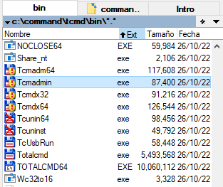

#10 Опубликовано: 19.06.2023 14:43:56
... that the installation process requires administrative privileges due to Windows UAC. Achieving a silent installation with a single click from a Windows dialog may not be feasible, as most users are unlikely to start SMath as an administrator.
Hi. If a program needs administrator permissions it can request them. As far as I know, it doesn't have to be SMath, but the Maxima installation manager to do it. For example, Total Commander does it through the Tcadmin.exe program, I don't know if Far manager has that ability.
