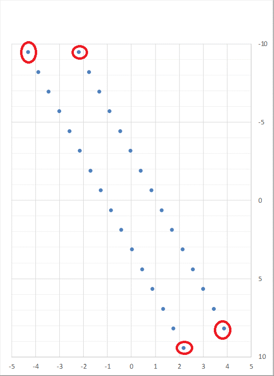

Hi Ioan, thats a good start :-). My aplogies for not wording my request more clearly. I need to identify following points programmatically.
For any generic array of XY data there are (in my case always 4) corner points that I need to find and identify.
The issue that I faced is that for some of 4 corners the coordinates are not always MIN/MAX of the entire array... I have tried setting up a function based on MIN/MAX that does not work if a corner point is not defined by XY extremity value.

Thank you very much guys, both codes identify the points correctly (and point out that my plot is not correct actually). You have just identified the most heavily loaded piles in a pile group, something that till now I always had to do by hand when automating per-pile demand calculation.
Ioan, your code will need a small tweak to identify points 16 & 17 instead of just 16.

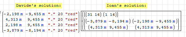

@Davide,
Very interesting your solution.
But in fact your solution gives almost the same results as mine's - one position exception:
Now, it's Alex's turn to use or to unvalidate.
