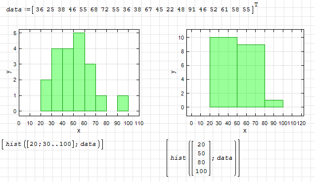

#3 Опубликовано: 12.01.2019 07:47:15
routine for X-Y plot
hist.sm (14,89 КиБ) скачан 1146 раз(а).
frapuano 12.01.2019 08:33:00

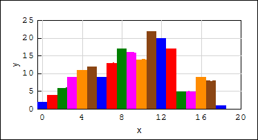

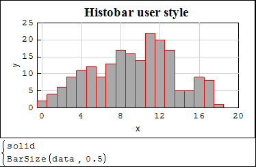

#9 Опубликовано: 13.01.2019 20:48:58
This demo to illustrate the CLT
From native Smath, you can have:
1. colors at will [rich from X_Y plot], even white to imitate no bar.
2. Slightly separated, joined, slightly overlapped.
3. solid or hatched at will.
Stat Histogram BarColor.sm (26,33 КиБ) скачан 1114 раз(а).
#10 Опубликовано: 14.01.2019 00:48:22
... or like this.
