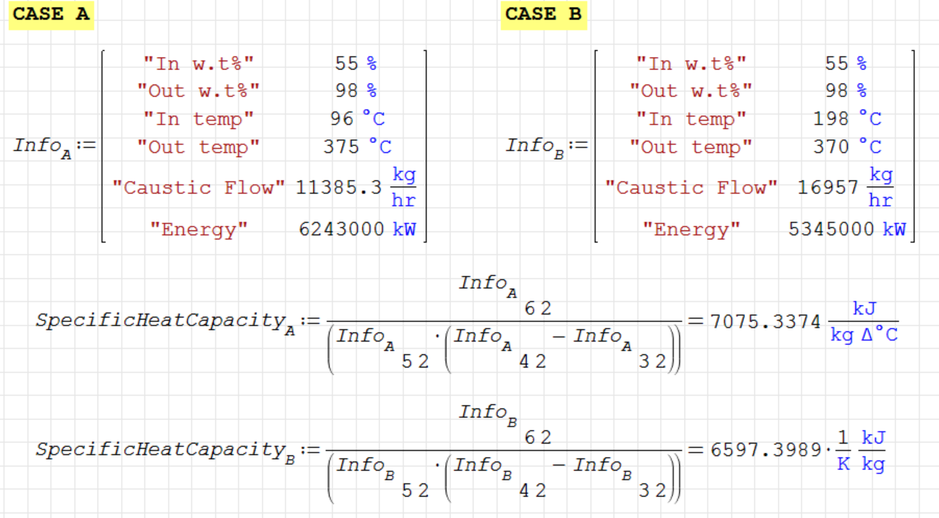

WroteRadovan, I do not think is correct your indication (Wrong/Right) as it is a temperature range you must use ' Δ °C.
Using the Kelvin grades instead this differentiation is not necessary (in fact in the Smath standard there is no ' Δ K).
Hello Sergio,
This was mentioned many times and I just wanted to point out that if you have something in ' °C you have to add or subtract in ' Δ °C (and not in ' °C) to get the result in ' °C.
I agree with you. The simplest thing is just to use ' Δ °C only when the temperature difference is the case.
I should have mentioned this as well.
I agree that the first line is wrong regardless what you actually want to express.
- If the two operands are really meant to be temperature points then the result is a change or difference of temperatures and it's unit must be left to K or set to Delta°C. Setting it to °C is wrong.
- If the second operand actually is meant to be a temperature difference or change, then it must have the unit K or Delta°C.
The second line can be right or wrong, depending on your actual intent.
- If the first operand is a meant to be a temperature point and second operand is meant to be a temperature difference or change, then the result is a temperature point and the unit can be K or °C. Nothing wrong then.
- Surely, if the equation is meant to represent something different, then it would be wrong. But that can be said of any equation in any document.
If everything is meant to be temperature differences, then this one is correct:
Smath does not do it independently (because it returns the result in ' K) and then if you want to act manually on the unit of measure ' Δ ° C
I would add that, indeed, for those who have not followed the numerous interventions on the forum, it is difficult to operate correctly.

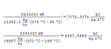

WroteIn my opinion, the correct writing is as follows:

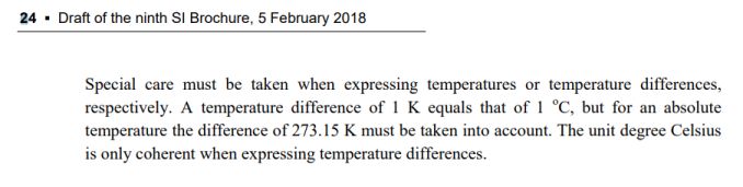

The last proposed revisions warm about the temperature differences, but claim for the use of ºC (https://www.bipm.org/utils/en/pdf/si-revised-brochure/Draft-SI-Brochure-2018.pdf):
So, I don't see the place of the Delta Celsius.
