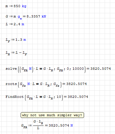

solve() calculates between -20/+20 unless different range is not specified.
This was your wrong doing here, result is way over 20. A well guessed range gives the result.
roots() must calculate without units like solve(), however you can fool functions by adding the unit of result.
Findroot() can calculate with unit but you have to give a starting guess value.
test_solve.sm (6,6 КиБ) скачан 782 раз(а).

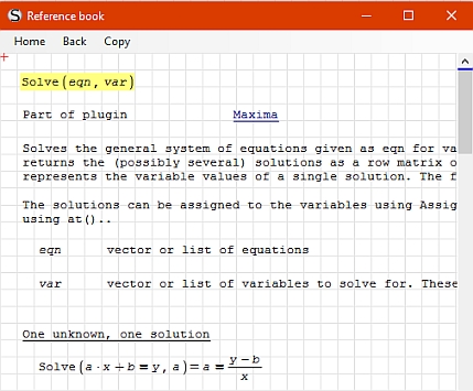

Btw. I installed the Maxima and I turn on the plugin in SMath. Could you tell me how to define the above equation for symbolic solution i.e. considering the GFa ???
Mi Astroneus. If you have Maxima, you can use Solve(). For learn about it (and a lot of things about Maxima and SMath) you can download the "Interactive SMath Handbook" by M. Kraska. Under Tools menu choose the interactive books option. If you don't have it, try to change "Local storage" to "Online gallery". The you can open it. Solve it's under Mathematics / Solving Non-Linear Equations / Solve.
Alvaro is right (like always), I have totally forgot maxima plugins's Solve() function cause I am not using windows for daily basis in a looong time.
There are also solvers like al_nleqsolve() or others in solving libraries/ plugins. You can find necessary informations for them in Reference Book, as Alvaro already mentioned.
