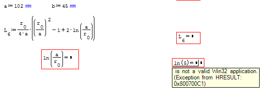

Please help! I am trying to do a simple natural log function and I keep getting the error " is not a valid Win32 application. (Exception from HRESULT: 0x800700C1)".
I am running v0.96 (build 4909) on Windows 7 x64.

hi mushoe
if you have installed one or more WIN 32 plugin delete it, then it should work
Greetings uham67

Do you use the unofficial portable distribution? If not, you might give it a try.
This is the correct link

I tried removing all plugins from my install, but that did not work. I then tried the portable version and it solved my issue!
Thank you so very much!
I had defined r0 above, I just forgot to move it down when I took the screen shot.

Just a follow up. I have been using the unofficial portable version for a while now and it has been working as expected with no strange errors. Thanks again to all for the help!
