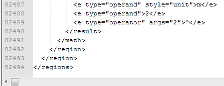

Trying to reopen a file that I wrote and that refused to be closed normaly, I receive this message:
"Unexpected end of file occured.
The following elements are not closed:
result, math, region, regions. Line 82490, position 12."
I posted the file here:
file
Is it possible to recover the file ? If yes, how ?
Thanks a lot for any help,
Ioan

the link to the file points to a hoster which requires login/registration. I won't create a login at a filehoster just to download a single file. You might use dropbox or the smath wiki file management.
The problem might be solved by just closing the xml tags in the file, but I can't try...
If that is the solution than I guess that SMath should be able to propose this approach and apply the fix.
Best regards, Martin
The solution is indicated by mkraska and the result is in the attached file

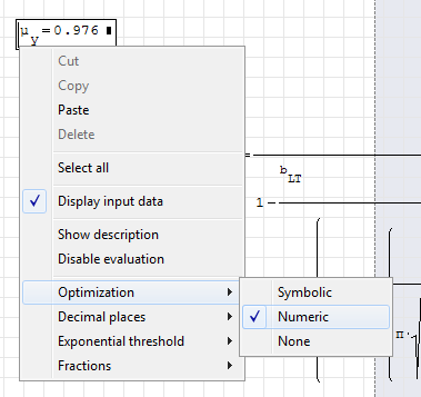

I still have a problem with this file:
all results are in fractional mode, against my temptatives of changing.
#6 Опубликовано: 03.07.2012 07:18:06
You are welcome
simply change the result optimization from "none" to "numeric"

Thanks again w3b5urf3r.
