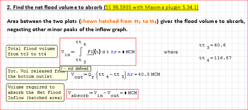

Two images WITH and WITHOUT Maxima plugin 5.34.1 attached.
SS file also attached
Reservoir Flood Capacity Estimation-R1.sm (189,41 КиБ) скачан 1079 раз(а).

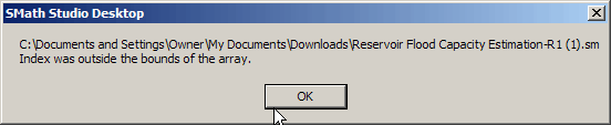

Sorry Collab: can't open the file.

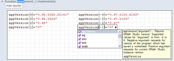

I had to update "Custom Functions" and download "Writer Region"
Also, in lieu of the SS version ..., use the new built in "appversion(3)=" function

By the way how do you use "appversion"?
#10 Опубликовано: 04.04.2016 16:49:13
Ruben Sidranski
Ruben Sidranski
#11 Опубликовано: 04.04.2016 22:28:57
