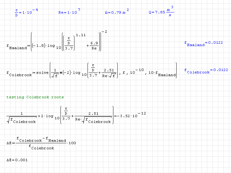

Hi
try using solve(4) instead of solve(2) or changing the "Roots (range)" value in "from 0 to 1" in "Tools" > "Options" > "Calculation"
in the attachment there is an example
regards,
w3b5urf3r

It should be noted here that the solve() gives you two solutions. Actually, there are no two solution and I do not know why solve() returned these two. On the other hand, we have to take into account that solve() depends on "Tools" > "Options" > "Calculation" >"Decimal places". If you use, for instance, 4 decimal places these are the solutions
[MATH=eng]el(f.Colebrook,1)=0.011542553663605[/MATH]
[MATH=eng]el(f.Colebrook,2)=0.01216608597662[/MATH]
15 decimal places
[MATH=eng]el(f.Colebrook,1)=0.012166073459707[/MATH]
[MATH=eng]el(f.Colebrook,2)=0.012166080958897[/MATH]
Solve() will return only one solution if your left boundary is not zero, but some small number greater than zero. Have in mind that in the equation you have [MATH=eng]1/sqrt(f)[/MATH].
(I changed displayed decimals with context menu for each result regardless of numbers of decimals chosen from the manu option)
On the other hand, roots() will give you a single solution which does not depend on decimal places chosen from the menu
[MATH=eng]roots(1/sqrt(f#)-(-2)*log({ε/D}/3.7+2.51/{Re*sqrt(f#)},10),f#,0.01)=0.012166080958897[/MATH]
But if you are far from the solution with your guess value, roots() will fail as could be expected when nonlinear equations are involved
[MATH=eng]roots(1/sqrt(f#)-(-2)*log({ε/D}/3.7+2.51/{Re*sqrt(f#)},10),f#,0.03)[/MATH]
That is the "beauty" of strugling with nonlinear equations
Representing 15 decimal places for this equation has no to much sence, I just put them here to point out the problematic results from solve().

Davide Carpi 26.06.2012 05:11:00
Thank you omorr, I was wondering
file updated with lower bound little but greater than zero (and Moody Diagram)...
regards,
w3b5urf3r
