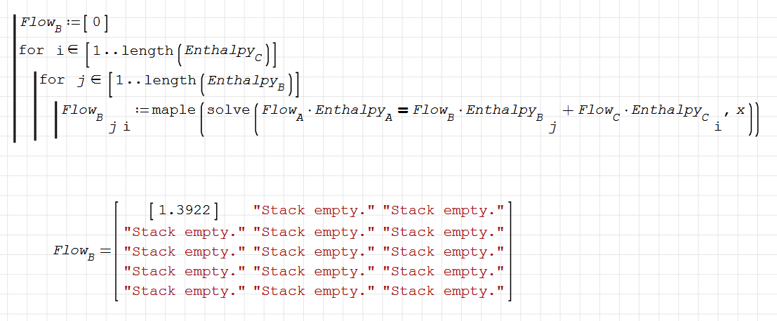

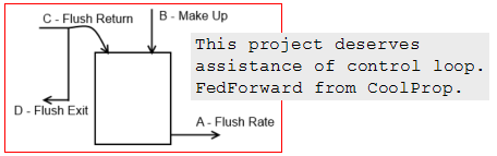

In my plant 20 pumps require flush water which is supplied by a close circuit water flow network. Flush rate & max temperature rise are per vendor specifications. Hot purge & simultaneous volume makeup by fresh water is what maintains the temperature.
I am attaching my solution to the problem. I further need to have multiple plots (on same graph) which corresponds to different temperature rises indicated by equation defining Tc. Please advice

#2 Опубликовано: 20.02.2023 03:48:32
Hi. Maybe, something like this?
FlushWater_updatedCoolProp2.sm (92,32 КиБ) скачан 1223 раз(а).

This should have worked ...the data dimensions are correct

I am waiting for a heat exchanger (with temperature loop) which will take x3 months. In the meantime I want to use make up water for temperature control by hot bleeding. Bleeded stream will not be wasted & goes to Cooling Tower makeup ...
Better wait the heat exchanger c/w control loop.
Detail: most likely the control algorithm will be Lead/Lag.
Your document is red. I will revisit.
