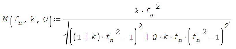

Hi, guys:
Here is a formula
And the Targets are:
1. Draw the plot, but only the first quadrant is required.
2. Find the value of fn when M is maximum.
3. Find the maximum value of M.
I did the 1st target successfully, but can not find the values of fn and M. I have tried my best and search the forum but could not find any way to fix it. Please help to fix it, Thank you very much!

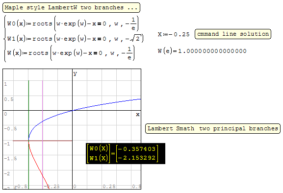

You need the Golden ratio ... doctored version.
If the function is a data set, spline/smooth the region
... as well the FindIndex is a good utility.
LLC Doctored for MAX.sm (27,88 КиБ) скачан 1067 раз(а).
Golden ratio QUICK Copy.sm (123,8 КиБ) скачан 1105 раз(а).

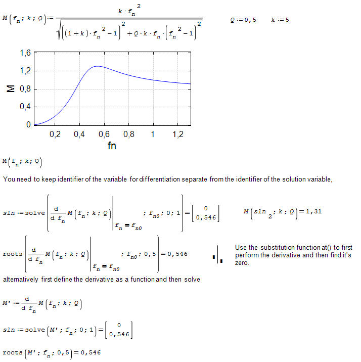

The built-in functions are perfectly well suited for the purpose. You just need to separate differentiation from root finding.
LLC.sm (11,01 КиБ) скачан 1099 раз(а).

... refreshed version.
Golden Search Copy.sm (23,62 КиБ) скачан 796 раз(а).

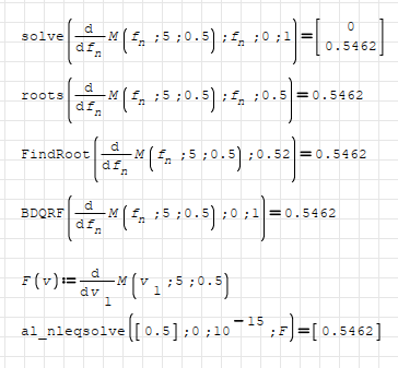

Here is your functions peak point solved with various solvers.
LLC1.sm (9,33 КиБ) скачан 1111 раз(а).

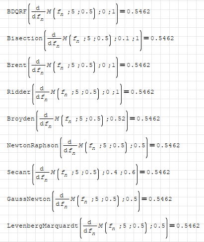

Apart from Findroot() there are other functions in Nonlinear Solvers to.
Check that plugins page in Reference Book, there may some info you can use.
LLC1.sm (13,8 КиБ) скачан 1124 раз(а).
