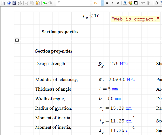

It doesn't seem to be an problem with the P1 font—I've always used it, and it worked perfectly before (my Windows system installed the P1 font). Additionally, when I opened the file today and switched the font to the P1, it functioned normally as well.image.png
