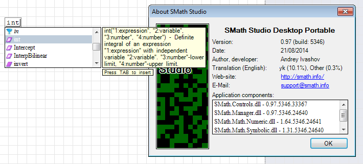

6179 Indefinite Int Missing
6179 Indefinite Int Missing - [not a bug] - Сообщения
#1 Опубликовано: 05.03.2017 23:44:00
'int' from the fx menu is the definite integration
operator over the [a,b] range. 'int(2)' gone with 6179.
No problem to fix from previous 5346, but inconsistent.
Think of new users !

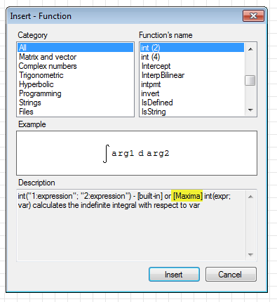

#2 Опубликовано: 06.03.2017 04:22:38
This is by design; functions like int(2) or lim(3) are just glyphs, they didn't work, hence are hidden (exactly to not generate confusion in newbie users).
If you have seen it in previous versions it was because some plug-in (Maxima Plugin).
  • 0.97.5346 without Maxima Plugin:

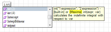

  • 0.97.5346 with Maxima Plugin:
#3 Опубликовано: 06.03.2017 04:28:13
1 356 сообщений из 2 271 понравились пользователям.
If you use the Maxima plugin and execute MaximaTakeover("all" ) then int(2) and lim(3) come to life, be it in older versions or in the current one. But the plugin was never able to populate the side palettes with buttons.

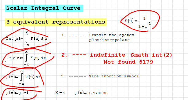

#5 Опубликовано: 07.03.2017 13:28:34
Hello Martin,
There must be a trick about "MaximaTakeover".
Does come with some of 68 plugins [6179] ?
The attached will rescue Smath 6179 new users.
Integral Curve.sm (11,95 КиБ) скачан 1140 раз(а).

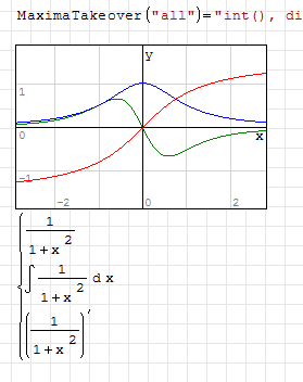

I am not sure, what was the point of your post.
- Need hints on the usage of MaximaTakeover? -> Interactive handbook, see Toolbar -> [?]
- Want to plot derivative or integral of some functions? Here you are:
I am not a new user, but your example is way too advanced for me.
The magic of defining functions without using their formal arguments on the right hand side of the definition is beyond my comprehension.
