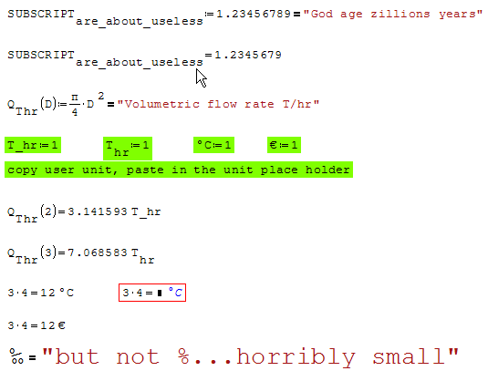

#3 Опубликовано: 19.07.2016 09:43:58
In maths works ang Engineering works, subscripts are confusing.
To me: completely useless, never use. Occasionaly, as short
description is usefull to evidence the RHS construction.
Further, Smath is very limited in the ASCII 'Alt+0key'. Probably
because of the so many languages it was designed to accomodate.
NONE of my Smath Engineering work sheet contains subscript.
Inst_Colebrook Pipe Data.sm (60,85 КиБ) скачан 1050 раз(а).
Inst_Orifice Plate.sm (430,13 КиБ) скачан 1092 раз(а).

#5 Опубликовано: 19.07.2016 15:52:35
Yes, csb531: underscore is a variable name by itself,
like this ... _(x):=sin(x)
or as a "union/separator" in variable name definition
as well as "union/separator" in subscripted text.
