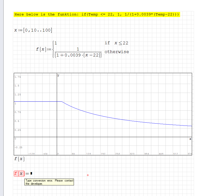

Hello everybody,
I use a beta-Version of SMath and have a question regarding the message:
"Type conversion error. Please contac the developer"
Problem_with_the_function.sm (4,31 КиБ) скачан 1140 раз(а).
Best regards,
Andrey

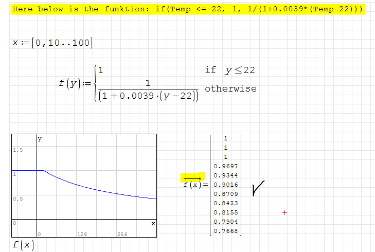

Do you want to get this result?
Problem_with_the_function_ser.sm (4,83 КиБ) скачан 1200 раз(а).
#3 Опубликовано: 27.03.2019 09:15:02
Andrey
Andrey
1 сообщений из 44 понравились пользователям.
Thank you very much, Sergio!
Yes, that's what I wanted to get.

#4 Опубликовано: 27.03.2019 11:16:50
Assign value for evaluation.
Problem_with_the_function.sm (5,08 КиБ) скачан 1154 раз(а).
