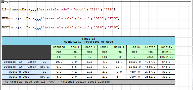

I have a dual boot machine running Ubuntu 16.04 and Windows 10, and my files are on a thumb drive. When working in Windows the plugin accesses the ods file without any problem:
