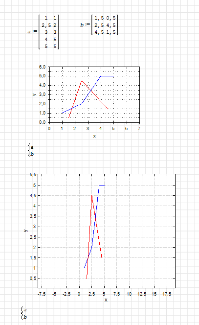

Hello.
Help me please!
How to find the intersection of two matrices. Sorry if I said wrong. An example is attached, a graph is built in it. The graph shows that there are two intersections. How do I find the intersection coordinates.
I have such a task. I need to get the third matrix, which begins as matrix (a), and after the intersection is constructed as matrix ( b ). Maybe someone knows the finished function. The matrices that we use in the problem always have two columns and a different number of rows. In the form of a matrix, we digitize graphs so that we can work with them.
Question_Intersection.sm (38,08 КиБ) скачан 1037 раз(а).

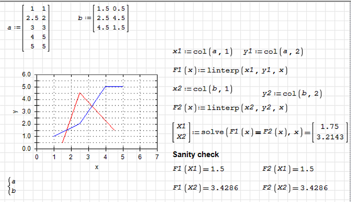

#3 Опубликовано: 27.11.2019 13:37:20
NDTM Amarasekera
NDTM Amarasekera
Help me please!
