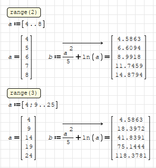

How it is better to set then an array of the data? Need to get a solution for some data (for example: values a 4, 5, 6, 7...)
Visit the Samples ... find zillions of examples.
#6 Опубликовано: 02.09.2023 20:35:19
587 сообщений из 1 361 понравились пользователям.
You can use range() functions.
