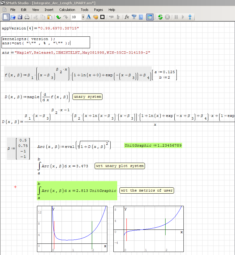

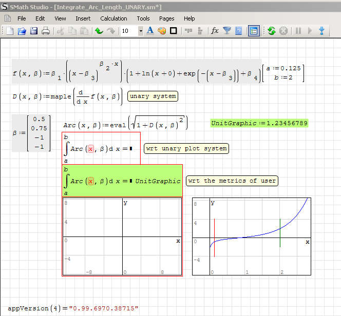

Hi Jean,
in which version did you prepare this example?
I use the last beta version, but I get a error 'x-not defined'
Thank you and best regards,
Andrey
It is probably because MapleTools returns β[#] instead of el(β,#)

"It is probably because MapleTools returns β[#] instead of el(β,#)"
Thank you, everything works without maple
MapleTools updated. Issue fixed.
... from Smath 6179.
As Davide points out, your latest freaks Maple !
