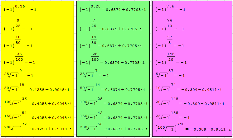

There is a bug I have encountered.
The result shouldn't be -1 or 1.
Result are correct for some not for others.
But we can't know when it is correct or not.

Not limited with exponents.
nthroot() suffers from this bug too.

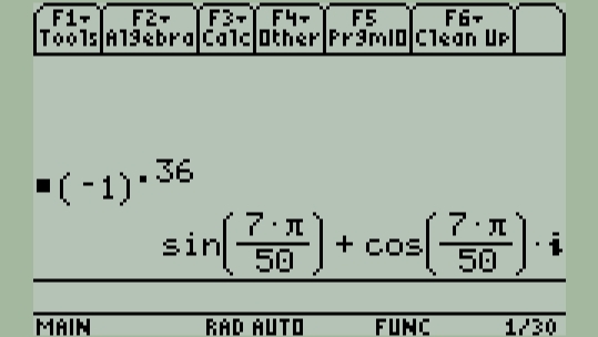

You are wrong.
Exponentiation of -1 or i has mathematical meaning.
What means is your calculators don't have rectangular form.
I don't care if it has practical usage or not.
Mathematics has it, period.
TI-89 Titanium:

No, it is wrong in SMath.
Other CAS softwares calculates it correctly.
Your are wrong here.
