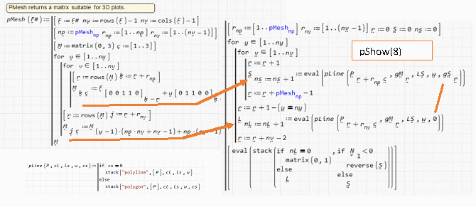

pMesh(1) gives the same answer than yours Createmesh. You can easily modify your code for adapt it as a new other function, maybe XYPlotShow or something else, identifiying the loops. There are the same, I check your Createmesh long time ago. Array S stores “polygon” or “polyline” if the colormap for surfaces is zero, and L stores “polylines” always, and are not filled like the polygons never. Thus, L are in the beginning, and what I see is that you need only let S as it is, or reversing it. My guess is that we only need to take the distances from some “ViewPoint”, not only two angles, but cannot found it. Also, notice that I take the bottom of each polygon for the colormap, and nothing else like averages. This way maybe is not the correct, but it is very fast, assigning before the main loops a complete array of color indices. Wolfram Mathematica use a 3D point as the view point as option, and maybe that’s more correct.

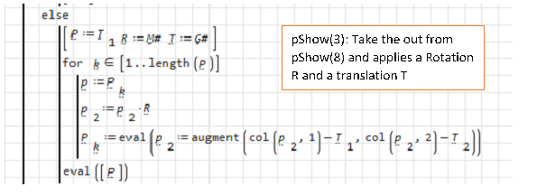

pSurf(3): This other could be interesting too, even I don’t show how to use because don’t test it too much (well, nothing). First two are for mapcolored “vf” vector field, “ip” implicit plots, but third option, when isn’t an string first parameter, for take P = pShow(8) and rotate by R and translate by T.
By this way you can plot the surface with some (az,el) and then replot for (90 deg, 0 deg), rotate and put down, like matlab surfc. Notice that the last parameter for pShow(8) is for which axis is the colormap, d=3 is the default for z=col(mesh,3). This is the output of matlab surfc:

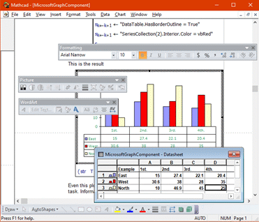

About other graphing options, my opinion is that MSChart component could be very important because they could export to Excel, if not easy, at least you ensure that. I attach my Mathcad 11 mschart component. It is implemented as a general ActiveX component in Mathcad. If you edit it’s code, you can see that the important code is:
ExecuteGlobal str + "End With"
MicrosoftGraphComponent.pdf (591,9 КиБ) скачан 868 раз(а).
This technique is based in this other files:
VBS.pdf (341,61 КиБ) скачан 810 раз(а).
Documenting Components.pdf (498,47 КиБ) скачан 879 раз(а).
Those files was published in the Mathcad advisor newsletter or something like that.
Backing to the mschart, if you now double click on it, you get the Microsoft environment for modify the plot, even it’s not saved you can found the way to get it. Look at the toolbars, are from Microsoft, not Mathcad. At the bottom you have also the sahpes toolbar!

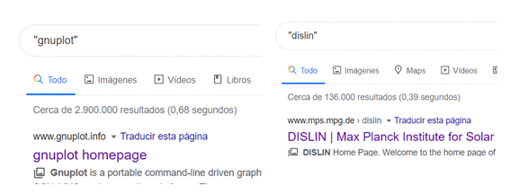

There are too many functions and they make it difficult to find functions in the SMath insert functions dialog. I think you should implement it as a single dislin function (str, a, b, c, ...) where str is the dislin instruction and the rest the arguments for that instruction.
You shouldn't let the user have to choose a file name and location to later display the graph in the image component. You can take the component directory, as you do in other plugins, or the temporary one in windows and make, for example, dislin ("disfin", 0) return the name of the file you have generated, with the full path, to insert it as final part of the component.
But the biggest problem with dislin is this other:
My recommendation is that if you do that for other software (my recommendation is gnuplot, which was already highly commented on in this forum) you would already have the complete graphics package.
