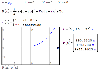

vector incorrect?
vector incorrect? - The values of the Pi vector, calculated for the previously defined function are invalid - Сообщения

However, by analyzing the individual values
any solution?

You must use the "vectorize" function to execute the operation element by element of the vector "ti"

#4 Опубликовано: 16.08.2018 13:37:25
any solution?
#5 Опубликовано: 16.08.2018 13:42:30
Cannonball project ...
Maths Cannonball Copy.sm (28,19 КиБ) скачан 1023 раз(а).
