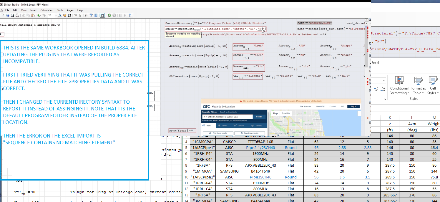

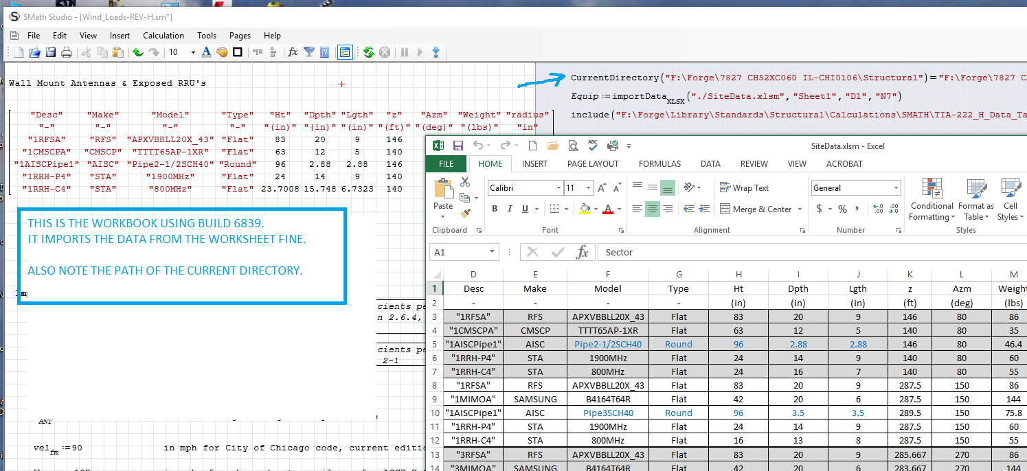

Hi all-
The latest build and upgraded the plugins that failed the check.
I am seeing some odd behavior in my Excel imports and in the results of CurrentDirectory variable.
Here is the worksheet before the upgrade-
Here it is after the upgrade to build 6884.
Here is a CamStudio capture trying to navigate the file. I was a full screen capture, so it might be a little small unless you expand it.
https://drive.google.com/file/d/1OP_hoYvbrngJv5TjfKUlCnby8LjFY2fH/view?usp=sharing
There is no audio, but I you can see after I open it, it re-calcs and the CurrentDirectory changes and the Excel import errs out. I tried to step through things to check them- the Excel sheet, the paths, the file location, etc... makes not sense to me.
After uninstalling and rolling back to 6839, all is fine withing the same worksheet.
Anyone have any ideas?
Dennis
#2 Опубликовано: 13.11.2018 06:36:29
1 436 сообщений из 2 919 понравились пользователям.
It is related to a plugin code cleaning made recently, I've made a patch to make it working again (plugin updated).
Will try to find something more consistant later.
