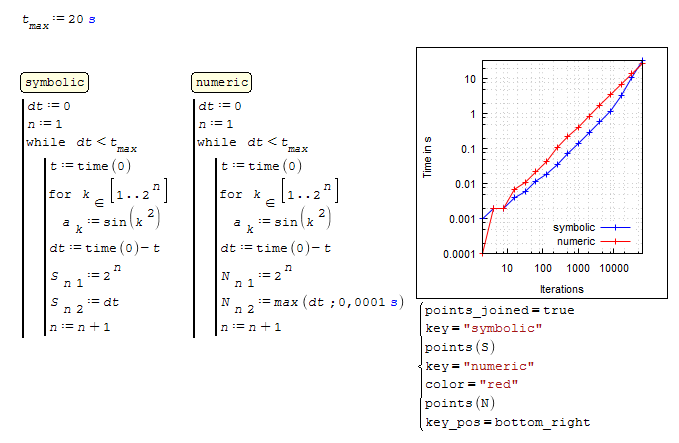

Regarding performance improvement (comparing latest stable and current nightly build):
Symbolic optimization (10000 items):
Numeric optimization (40000 items):

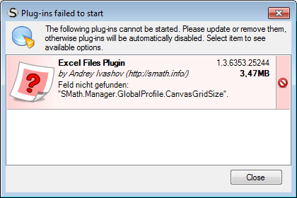

There is a strange user experience when installing plugins.
In the extension manager, everything (didn't install really everything, just the usual candidates) seems to be ok, except for the image region:
Then I close SMath and restart:

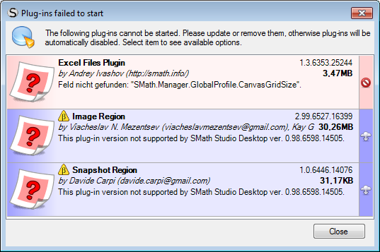

Then I update the just installed plugins, after restart I get this:
Image region works.

Symbolic element access costs scale over-linearly with vector size, numeric scales linearly
srt.sm (24,55 КиБ) скачан 1550 раз(а).
