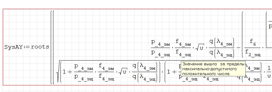

Who has faced such a problem, how can it be solved?

#2 Опубликовано: 12.02.2020 12:07:47
"result above max ..." has no pertinent meaning in your project.
If you attempt "roots" on the numerator only ... "Units don't match"
No need to go further ... zap the units in the project.

I made a mistake, there should be a solve function, in this place the same error
#4 Опубликовано: 12.02.2020 14:57:49
Same answer: Units don't match.
How can you solve what you can't plot or evaluate ?

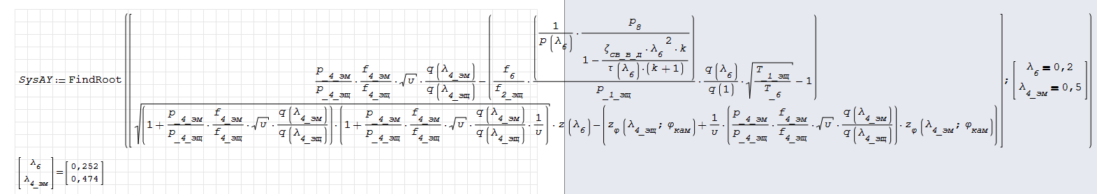

#5 Опубликовано: 13.02.2020 07:44:15
1 353 сообщений из 2 264 понравились пользователям.
You can use the function FindRoot() from the Nonlinear Solvers plugin. The function automatically assigns the solution to the variables.
Единицы измерения здесь не при чем.

why do you use 0.2 and 0.5?

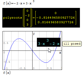

#13 Опубликовано: 15.02.2020 17:54:43
Always avoid ill posed polynomials.
