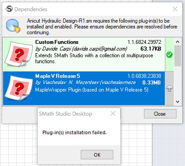

The latest MapleWrapper plugin fails to install.
Tried several clean installation of latest SS, but did not solve this problem.

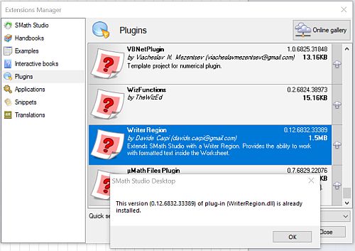

Then I get another problem with WriterRegion. Some link????
The only way for me was to do a clean re-installation without trying to install MapleWrapper, and then WriterRegion can be installed. Any attempt to install MapleWrapper will trigger the same problem with WriterRegion. I don't know why?

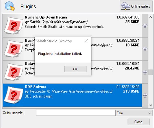

The MapleWrapper new build works now. But see the following. Very strange.
Cannot install TextRegionUtilities also, as indicated by Davide.

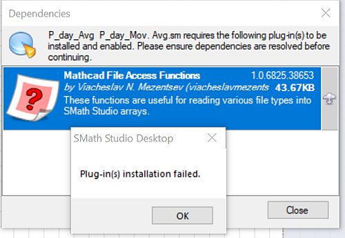

Attached file last opened and saved on 11/09/2018, but now
fails due to MathcadFileAccess plugin failing to install.
