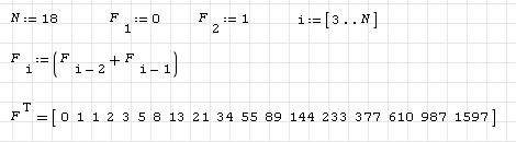

hello all,
i'm trying to recreate fibonacci sequence in the way as below but i'm stuck. it is possible to do sequence like below in smath ?
fibo" alt="seq" title="seq" class="img-user-posted img-thumbnail" style="max-height:100px;">

Yes you can, but you have to work in base 1 indices (first vector element index is 1, 18th elemnt index is 18).
https://it.smath.com/cloud/worksheet/ZHppgvSG
