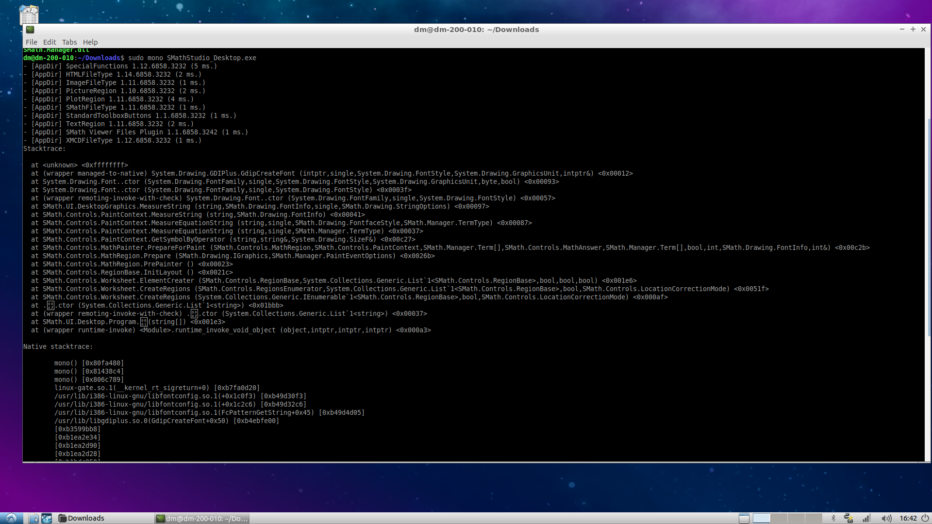

The stack trace would be really useful
I can reproduce something similar in Linux Mint, it's the same issue?
mono SMathStudio_Desktop.exe
- [AppDir] SpecialFunctions 1.12.6839.38235 (9 ms.)
- [AppDir] HTMLFileType 1.14.6839.38235 (3 ms.)
- [AppDir] ImageFileType 1.11.6839.38235 (0 ms.)
- [AppDir] PictureRegion 1.10.6839.38235 (1 ms.)
- [AppDir] PlotRegion 1.11.6839.38235 (9 ms.)
- [AppDir] SMathFileType 1.11.6839.38235 (0 ms.)
- [AppDir] StandardToolboxButtons 1.1.6839.38235 (0 ms.)
- [AppDir] TextRegion 1.11.6839.38235 (0 ms.)
- [AppDir] SMath Viewer Files Plugin 1.1.6839.38249 (0 ms.)
- [AppDir] XMCDFileType 1.12.6839.38235 (1 ms.)
Stacktrace:
  at <unknown> <0xffffffff>
  at (wrapper managed-to-native) System.Drawing.GDIPlus.GdipCreateFont (intptr,single,System.Drawing.FontStyle,System.Drawing.GraphicsUnit,intptr& <0xffffffff>
  at System.Drawing.Font..ctor (System.Drawing.FontFamily,single,System.Drawing.FontStyle,System.Drawing.GraphicsUnit,byte,bool) <0x000af>
  at System.Drawing.Font..ctor (System.Drawing.FontFamily,single,System.Drawing.FontStyle) <0x00047>
  at (wrapper remoting-invoke-with-check) System.Drawing.Font..ctor (System.Drawing.FontFamily,single,System.Drawing.FontStyle) <0xffffffff>
  at SMath.UI.DesktopGraphics.MeasureString (string,SMath.Drawing.FontInfo,single,SMath.Drawing.StringOptions) <0x000cf>
  at SMath.Controls.PaintContext.MeasureString (string,SMath.Drawing.FontInfo) <0x0004f>
  at SMath.Controls.PaintContext.MeasureEquationString (string,single,SMath.Drawing.FontfaceStyle,SMath.Manager.TermType) <0x00097>
  at SMath.Controls.PaintContext.MeasureEquationString (string,single,SMath.Manager.TermType) <0x0003f>
  at SMath.Controls.PaintContext.GetSymbolByOperator (string,string&,System.Drawing.SizeF& <0x00f5f>
  at SMath.Controls.MathPainter.PrepareForPaint (SMath.Controls.MathRegion,SMath.Controls.PaintContext,SMath.Manager.Term[],SMath.Controls.MathAnswer,SMath.Manager.Term[],bool,int,SMath.Drawing.FontInfo,int& <0x00c9f>
  at SMath.Controls.MathRegion.Prepare (SMath.Drawing.IGraphics,SMath.Manager.PaintEventOptions) <0x002d7>
  at SMath.Controls.MathRegion.PrePainter () <0x00017>
  at SMath.Controls.RegionBase.InitLayout () <0x002a9>
  at SMath.Controls.Worksheet.ElementCreater (SMath.Controls.RegionBase,bool,bool,bool) <0x0027d>
  at SMath.Controls.Worksheet.CreateRegions (System.Collections.Generic.IEnumerable`1<SMath.Controls.RegionBase>,bool,SMath.Controls.LocationCorrectionMode) <0x0064f>
  at ...ctor (System.Collections.Generic.List`1<string> <0x01e4b>
  at (wrapper remoting-invoke-with-check) ...ctor (System.Collections.Generic.List`1<string> <0xffffffff>
  at SMath.UI.Desktop.Program. (string[]) <0x0024b>
  at (wrapper runtime-invoke) <Module>.runtime_invoke_void_object (object,intptr,intptr,intptr) <0xffffffff>
Native stacktrace:
	mono() [0x4b73d8]
	mono() [0x50f13b]
	mono() [0x423d22]
	/lib/x86_64-linux-gnu/libpthread.so.0(+0x10330) [0x7fa34a779330]
	/usr/lib/x86_64-linux-gnu/libfontconfig.so.1(+0x1b2ed) [0x7fa34552f2ed]
	/usr/lib/x86_64-linux-gnu/libfontconfig.so.1(+0x1ba29) [0x7fa34552fa29]
	/usr/lib/x86_64-linux-gnu/libfontconfig.so.1(+0x1c798) [0x7fa345530798]
	/usr/lib/x86_64-linux-gnu/libfontconfig.so.1(+0x1c980) [0x7fa345530980]
	/usr/lib/libgdiplus.so.0(GdipCreateFont+0x62) [0x7fa346b562c2]
	[0x415b2943]

I started with 6858 and got some font errors. After installing a few fonts - e.g. Andale - I got less errors, but the application still crashed. Then I tried 6839 getting the same error messages. Version 6670 seemed to work initially even though a X11 error was reported. Only after loading the above mentioned examples SMAth crashed. Sorry, I skiped testing 6671. Today I tried 6671 on Mint. The same X11 error is still there, but Newton example loads without crashing.
6858 AND 6839 on Mint
No X11 error on startup, but GDI+ error
<<<<<<<<<<<<<<<<<<<<<<<<<<<<<< 6858 >>>>>>>>>>>>>>>>>>>>>>>>>>>>>>>>>
jro@jro19 ~/Programs/SMathMono_6858 $ mono SMathStudio_Desktop.exe
- [AppDir] SpecialFunctions 1.12.6858.3232 (6 ms.)
- [AppDir] HTMLFileType 1.14.6858.3232 (3 ms.)
- [AppDir] ImageFileType 1.11.6858.3232 (1 ms.)
- [AppDir] PictureRegion 1.10.6858.3232 (3 ms.)
- [AppDir] PlotRegion 1.11.6858.3232 (4 ms.)
- [AppDir] SMathFileType 1.11.6858.3232 (0 ms.)
- [AppDir] StandardToolboxButtons 1.1.6858.3232 (1 ms.)
- [AppDir] TextRegion 1.11.6858.3232 (1 ms.)
- [AppDir] SMath Viewer Files Plugin 1.1.6858.3242 (2 ms.)
- [AppDir] XMCDFileType 1.12.6858.3232 (1 ms.)
Unhandled Exception:
System.ArgumentException: The requested FontFamily could not be found [GDI+ status: FontFamilyNotFound]
  at System.Drawing.GDIPlus.CheckStatus (Status status) <0xb491ac90 + 0x007ef> in <filename unknown>:0
  at System.Drawing.Font..ctor (System.Drawing.FontFamily family, Single emSize, FontStyle style, GraphicsUnit unit, Byte gdiCharSet, Boolean gdiVerticalFont) <0xb298d528 + 0x0009f> in <filename unknown>:0
  at System.Drawing.Font..ctor (System.Drawing.FontFamily family, Single emSize, FontStyle style) <0xb298d4d8 + 0x0003f> in <filename unknown>:0
  at (wrapper remoting-invoke-with-check) System.Drawing.Font:.ctor (System.Drawing.FontFamily,single,System.Drawing.FontStyle)
  at SMath.UI.DesktopGraphics.MeasureString (System.String text, SMath.Drawing.FontInfo font, Single width, SMath.Drawing.StringOptions format) <0xb275da00 + 0x00097> in <filename unknown>:0
  at SMath.Controls.PaintContext.MeasureString (System.String text, SMath.Drawing.FontInfo font) <0xb275d970 + 0x00041> in <filename unknown>:0
  at SMath.Controls.PaintContext.MeasureEquationString (System.String text, Single size, FontfaceStyle style, TermType type) <0xb276bc88 + 0x00087> in <filename unknown>:0
  at SMath.Controls.PaintContext.MeasureEquationString (System.String text, Single size, TermType type) <0xb276bc28 + 0x00037> in <filename unknown>:0
  at SMath.Controls.PaintContext.GetSymbolByOperator (System.String oper, System.String& text, System.Drawing.SizeF& size) <0xb276a3d8 + 0x00c27> in <filename unknown>:0
  at SMath.Controls.MathPainter.PrepareForPaint (SMath.Controls.MathRegion region, SMath.Controls.PaintContext ctx, SMath.Manager.Term[] input, SMath.Controls.MathAnswer answer, SMath.Manager.Term[] units, Boolean inputDataVisibility, Int32 currentTermIdx, SMath.Drawing.FontInfo font, System.Int32& middleLine) <0xb274e000 + 0x00c2b> in <filename unknown>:0
  at SMath.Controls.MathRegion.Prepare (IGraphics g, SMath.Manager.PaintEventOptions e) <0xb2768218 + 0x00243> in <filename unknown>:0
  at SMath.Controls.MathRegion.PrePainter () <0xb27681e0 + 0x00023> in <filename unknown>:0
  at SMath.Controls.RegionBase.InitLayout () <0xb2767f90 + 0x0022c> in <filename unknown>:0
  at SMath.Controls.Worksheet.ElementCreater (SMath.Controls.RegionBase region, System.Collections.Generic.List`1 regions, Boolean makeCurrent, Boolean batchProcessing, Boolean invalidateRequired) <0xb27656b8 + 0x001e6> in <filename unknown>:0
  at SMath.Controls.Worksheet.CreateRegions (SMath.Controls.RegionsEnumerator enumerator, System.Collections.Generic.List`1 regions, Boolean showProgress, LocationCorrectionMode locationCorrection) <0xb2764128 + 0x00517> in <filename unknown>:0
  at SMath.Controls.Worksheet.CreateRegions (IEnumerable`1 newRegions, Boolean showProgress, LocationCorrectionMode locationCorrection) <0xb2763ae0 + 0x000af> in <filename unknown>:0
  at ...ctor (System.Collections.Generic.List`1 ) <0xb2be8fb8 + 0x01bbb> in <filename unknown>:0
  at (wrapper remoting-invoke-with-check) .:.ctor (System.Collections.Generic.List`1<string>

dmmartinez
dmmartinez
Just installed Lubuntu 18 LTS on an HP Stream mini and wanted to install SMath (0_99_68658). Installed mono and double clicked the .exe and is tries to load, then nothing. Tried in terminal in mono. Got a set of errors about missing font library. Tried again to do a scree capture and had a slightly different error. Attached screenshots. Also said: debug info from gdb:
Got a SIGSEGV while executing native code. This usually indicates
a fatal error in the mono runtime or one of the native libraries
used by your application.
Показать спойлер
