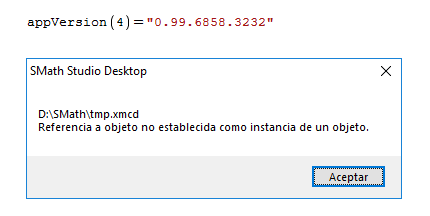

I know the limitations for importing Mathcad files. I have used it in the last couple of months without much trouble to partially import old mathcad sheets.
But, i get this error with the latest version: "Object reference not set to an instance of an object."
Thanks!

I observed the same error with the same Smath Studio version on Windows 8.1 (German). The message appears in German:
"Der Objektverweis wurde nicht auf eine Objektinstanz festgelegt".
Should I try to reinstall version 0.99.6839 - Stable (released at 2018-09-22) - recommended?
Thanks for the help in advance.

Just an update to the above error message. I uninstalled the latest beta version and installed the last stable version 0.99.6839. The problem was solved. I can open/import Mathcad files (.xmcd).
Thanks!
Thank you for the report. Issue is fixed now. Fix will be available into the next beta release.
