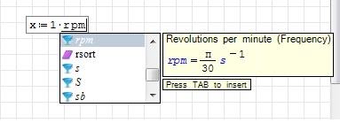

I am new using sMath Studio so this is likely to be something I am doing wrong but I haven't been able to make sense out of it so I'll just report it.
rpm is defined as pi/30 (1/s) . That is what it shows when I hover over a variable defined with that unit.

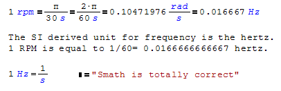

#9 Опубликовано: 07.09.2016 14:08:42
1 rpm = 1 rev/min = 1/60 rev/sec
And it is exactly how it is defined in SMath
But 1 revolution is equal to 360° (2pi)
If you don't need relationships with the angles (the 2pi factor), simply redefine rpm

By the way, even sMath Studio (once you hover over the unit) displays it as a frequency (not angular velocity).

#16 Опубликовано: 09.09.2016 09:24:11
1 356 сообщений из 2 271 понравились пользователям.
Good point indeed. This should be changed. It also applies to some other units. This can be seen best in the insert unit dialog. There, some categories are missing:
angular velocity
angle
The angular units currently are categorized as dimensionless.
Filed as SS 2395
#17 Опубликовано: 09.09.2016 22:20:41
To deplease previous comments, Smath is totally correct
in this thread. It just happened that some i... at the
SI system decided not to count rpm on fingers but on
fractional fingers. End of it, Smath OK !
