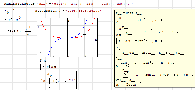

I am trying to solve the problem that I can't overwrite special functions in the Maxima plugin via the IPluginLowLevelEvaluation.ExpressionEvaluation interface, see SS-2401.
Obviously one can add definitions to the canvas from within a plugin function execution using something like this:
Entry lhs = Entry.Create(TermsConverter.ToTerms("int(f,x,a,b)");
Entry rhs = Entry.Create(TermsConverter.ToTerms("Int(f,x,a,b)"); ;
Entry def = context.AddDefinition(lhs, rhs);
This replaces the built-in definition of int(4) with the one provided by the maxima plugin in the current downstream canvas.
The above solution was found by blindly poking around, assisted by the Core doc.
Questions:
- Can I generate the definition directly from the text representations?
- How can I remove the definition?
- It seems that the variable names used in the definitions matter. int() does not provide the same results as Int() in some cases.
- What plugin might be a good source of inspiration for the above questions?

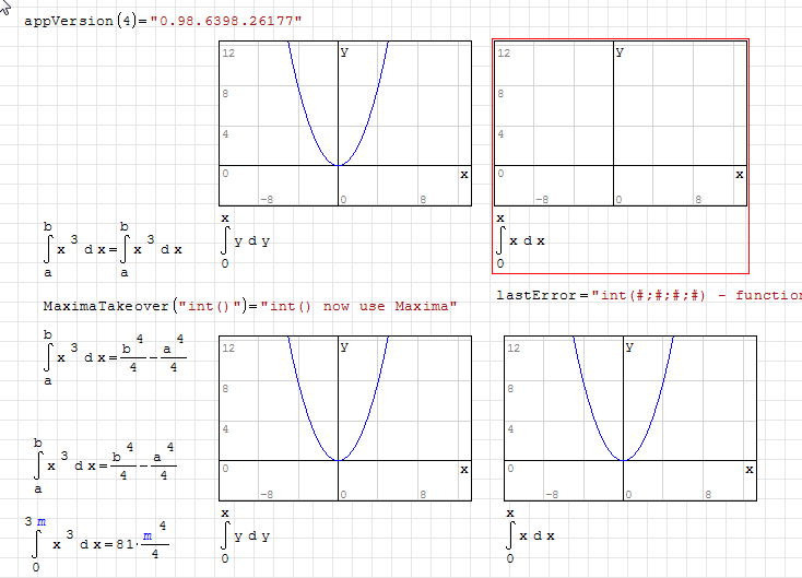

I implemented a new MaximaTakeover() function, which adds definitions to the context or removes them according to the given arguments. First tests seem very promising, such that the full functionality of the Maxima plugin can be re-established soon.
It turned out that something like
int index;
if (context.Contains(lhs, out index) context.RemoveAt(index);
didn't do the job of deleting the definitions from the global context. The deletion actually worked (as per inspection in the debugger) but that was of only local scope. I had to resort to Clear().

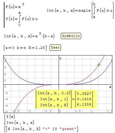

#8 Опубликовано: 31.07.2017 13:08:43
Hello Martin,
Interesting, though the algo style is native in Smath 5346, 6179
except the first release 6179 is missing Int(2) [indefinite].
I think Sum will work as well, at least it was 5346.
Cheers, Jean
