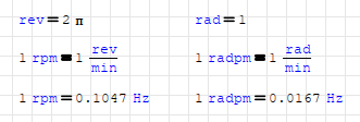

It seems that this issue from 10 years ago has resurfaced (I'm using version 0.99 Build 7822 on 64-bit Windows 10). I'm responding to this long dead thread, since this is clearly the same problem as before, and a Google search didn't find any other similar problems).
SMath (erroneously) produces:
1 rpm = 0.1047 Hz (= 2π/60 Hz)
1 radpm = 0.0167 Hz (= 1/60 Hz)
2π Hz = 60 rpm (= 1 rev/s)
2π rad/s = 6.2832 Hz (= 2π Hz)
Doing a manual unit conversion (paper method) reveals that the above values are wrong:
1 rpm = 1 rev/min * (1 min)/(60 s) = 1/60 * rev/s = 0.0167 Hz ====> (NOT: 0.1047 Hz)
1 radpm = 1 rad/min * (1 min)/(60 s) * (1 rev)/(2π rad) = 0.00265 Hz = 1/(60*2π) Hz = 1/(120π) Hz ====> (NOT: 0.0167 Hz)
2π Hz = 2π cycle/s = 2π rev/s * (60 s)/(1 min) = 2π*60 rev/min = 120π rpm = 376.99 rpm ====> (NOT: 60 rpm)
2π rad/s = 2π rad/s * (1 rev)/(2π rad) = 1 rev/s = 1 Hz ====> (NOT: 2π Hz)
Oddly, SMath does have the units right for both rev|rad and min|s:
1 rev = 6.2832 rad = 2π rad
1 rad = 0.1592 rev = 1/(2π) rev
1 min = 60 s
1 s = 0.0167 min
But as soon as they're combined with time, SMath manages to mess up the calculation:
1 Hz = 1 rad/s ====> (should be) ====> 2π rad/s
1 rev/min = 1 rpm = 0.1047 Hz ====> (should be) ====> 1 rev/min = 0.0167 Hz
1 rad/min = 1 radpm = 0.0167 Hz = 1/(60 s) = 1/60 s^-1 ====> (should be) ====> (1/60 rad/s OR (1 rad)/(60 s) --- maweilian's proposal about radpm incorrect... what he said should be applied to rpm, NOT radpm).
One rev/cycle/rotation is basically the "real" unitless value. Everything else is defined therefrom: 1 rotation = 1 cycle = 1 revolution = 360° = 2π rad = 4 quarters, etc.
Since Hz is defined as "one cycle per second" (1/s), it is a unit of frequency. rpm is a unit of angular *frequency*, while radpm is a unit of angular *velocity*. Therefore, rpm should be defined in terms of 1/s, or "cycles per unit time" while radpm should be defined in terms of rad/s, or "radians per unit time". In other words, radians [rad] are defined with respect to cycles [] by:
1 [] = 2π [rad] ===> [rad] = 1/(2π) []
Making rpm and radpm defined with respect to frequency ([Hz] = []/[s]):
rpm = [rev]/[min] = []/[min] * (1 [min])/(60 [s]) = 1/60 []/[s] = 1/60 [Hz]
radpm = [rad]/[min] * (1 [])/(2π [rad]) * (1 [min])/(60 [s]) = 1/(2π*60) []/[s] = 1/(120π) [Hz]

You are mistaken. RPM in SMath is broken (see my responses on the thread you referenced, as well as my remarks below).
The misunderstanding likely comes from interpreting rpm strictly as an angular velocity (which it technically is), when it is more accurate to call it a rotational frequency. If you drive a piston from a journal bearing on a crankshaft, the frequency of that piston, in Hz (from top-dead-centre to the subsequent top-dead-centre) is equal to one-sixtieth of the cranshaft rpm.
The frequency of the shaft is equal to the frequency at which the shaft returns to the same position (and therefore results in the same piston position), or how frequently it passes n*2π radians from its starting position, where n is the number of turns (revolutions) since measurement started.
At 3000 rpm, that's a rotational frequency of 50 Hz, and a piston frequency of 50 Hz (NOT 314.1593 Hz).
The crankshaft would be turning at an angular velocity of: 50 Hz * (2π rad/s)/(1 Hz) = 100π rad/s = 314.1593 rad/s (again, NOT 314.1593 Hz).
