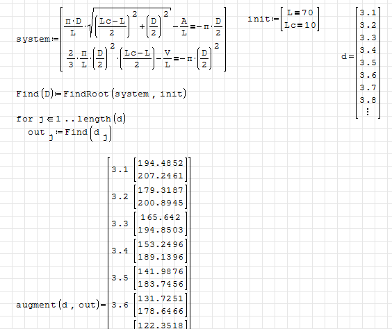

#2 Опубликовано: 01.06.2017 12:15:32
I guess is not possible (?) with current version, one reason (but not the only) is because embedded assignments.
Will works with the refactored version, though.
Radovan Omorjan 01.06.2017 14:01:00
#3 Опубликовано: 01.06.2017 14:54:16
Thanks Davide,
In the mean time: I did, a bit differently.
Next => collect for the plot.
