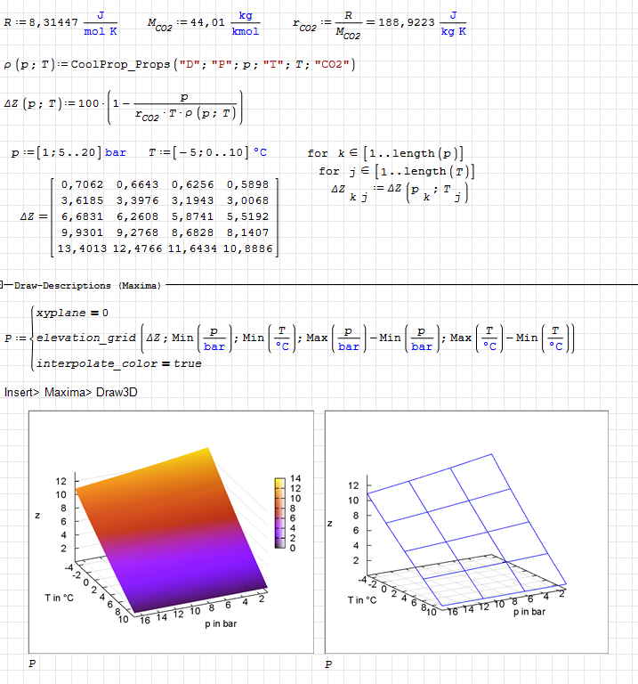

i would like to create 3d plot of compresibility with p and T as axis. How can i do that?
Thanks,
Tomáš

Hi. This is a way.
Z-CO2.sm (16,56 КиБ) скачан 520 раз(а).
Отредактировано 14.12.2025 05:15:11

Wow, thanks.
i would like to use char3D or Maxima plot. Is the procedure same?

Hi Tomas. I assume so. And also in maple, dislin, and others. But I'm not skilled enough in those methods to show you the most effective way to use them.
