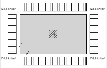

I'm using SMath to create simple structural engineering calculations.
I'd like to add sketches/visualizations of the calculated structure.
What would be the best tools to achieve this?
Here's an example of what I'm trying to do.
Best regards, Olli
