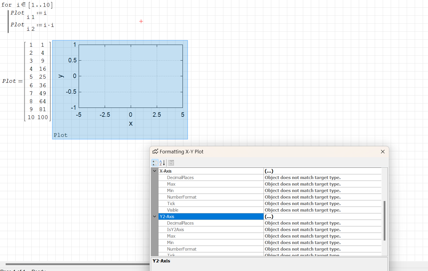

I have just tried to use Smath, after a break of two or three months. I can't get the x-y Plots to work. When I try to adjust the scales, etc, from the defaults, I get the message "object does not match target type" in most/all sections.
I checked with an older file that used x-y Plots - the plots displayed properly, but I still got the same messages when I tried to access the scales, etc.

Hi
Here's a screenshot.

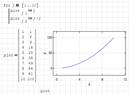

#8 Опубликовано: 30.10.2024 23:58:07
No problems here as well.
XYplot.sm (9,88 КиБ) скачан 1548 раз(а).
If you install the development tools plugin, in the "Insert" > "Development tools" > "System informations" dialog you can retrieve all the relevant framework and system information.

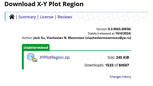

You can install an older version from the list here:
https://smath.com/en-US/view/XYPlotRegion/history
