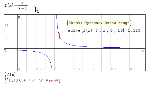

The discontinuity of the function at x = 1 creates some numerical problem.
As shown in the figure, trying different intervals are obtained unexpected values.
[albumimg]1436[/albumimg]
... always plot before solving, bracket the range wisely [1,2]

... so, let's revisit f1(x). This function will reach infinity @ x=5. You can see that by inspection.
log(x-5,0.5)=ln(-5+x)/ln(1/2). What that means is that in the "bisection" process, if the bracketed
values do create '5', it won't go any further. It won't go any further as long as as the mean of the
bracketed values will be symmetric @ '5' ... (3.75+6.25)/2 = 5.
In that case and in any real application or Edu.Quiz, it is necessary and sufficient to create
asymmetry to escape the bisection = 5. You may argue that (3.95+6.05)/2 is exactly '5'. Yes it is
but it is paper pencil but not numerically wrt to the [/] divide operator, and that invisible asymmetry
is now sufficient to escape the bisection from being excatly '5'.
solve(f1(x)≡0,x,3.95,6.05)=mat(4,6,2,1)... the two solutions are found.
