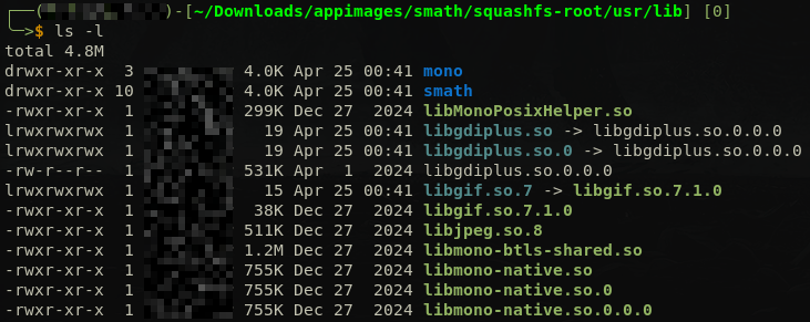

As I have already said, I can run smath appimage in a qemu linuxmint22.3-cinnamon virtual machine.
Even though appimages have libgdiplus.so file in them, somehow some computers simply ignore it.
Here is the contents of the appimage, you can see libgdiplus is already included.
Your terminal output file indicates libgdiplus file couldn't be found.
Install libgdiplus with sudo apt update && sudo apt install libgdiplus and try again to run appimage.
