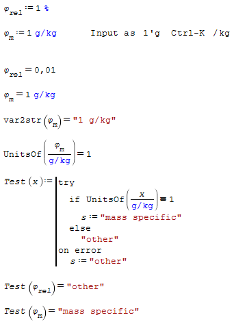

I would like to create a wrapper function for some CoolProp functions and use different parameters according to the unit of the input variable (if the relative or mass-specific air humidity was entered):
I have tried the special function UnitsOf(), but it only returns the base unit like the special function UoM() of the variable (I guess because SMath saves the variable internally with the base unit). I am looking for a way to find out, which unit was entered by the user when defining the variable. Does anybody know which function I could use or does anybody have an idea how I could achieve the input unit detection?

I decided to redefine the percent unit so that I can easier enter the g/kg ratio. The disavantages are that I have to use the unit % for relative humidity and that I cannot convert other ratios or efficiencies directly into percentages, but have to do it manually by multiplying it with 100 % (which is okay for me):

WroteI would be very cautious with re-definition of built-in units.
This increases the chance for your document to be misunderstood (including by yourself).
What was the disadvantage of defining a custom unit "g/kg"?
Remember: Mike had long comments about CoolProp
WroteI decided to redefine the percent unit so that I can easier enter the g/kg ratio.
