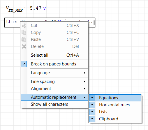

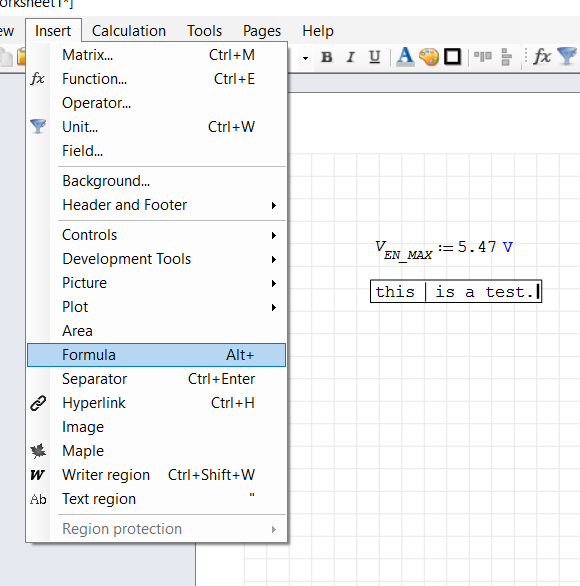

And now there is a simpler way to write formulas in text regions.
If equation replacement is enabled for that particular text region,
you can insert > formula and directly write anything math involded.
And it will be evaluated and changed according to variable value.
So you won't need to copy/paste everything.
