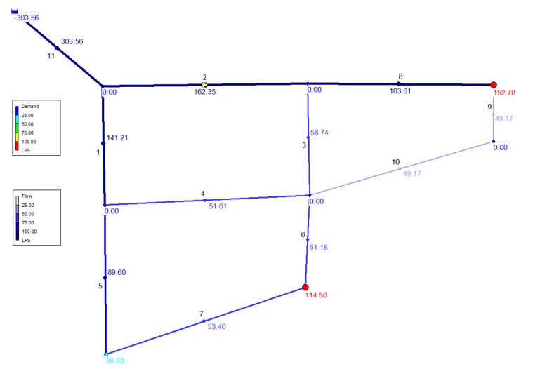

I have used Epanet to solve your exercise, by the Hazen Williams method with the following assumptions:
Minimum tank height 66 meters
the roughness of the pipe 120
node height 0 meters
diameter in millimeters
pipe length in meters
Carlos

Thank you Carlos.

I am extremely sorry that in my last example on 3 LOOPS, I have made a careless mistake in Program 2 to calculate the appropriate corrections in the network. The results were wrong.
Furthermore, for simplicity, I assumed a fixed friction factor instead of the method given in the original EXCEL file in the web.
The revised SM and EXCEL files are attached. They both tally. The original EXCEL file had only 5 trials and I extended to 10 trials.
Also, many thanks to Carlos for his example using EPANET which prompted me to check and correct my program.

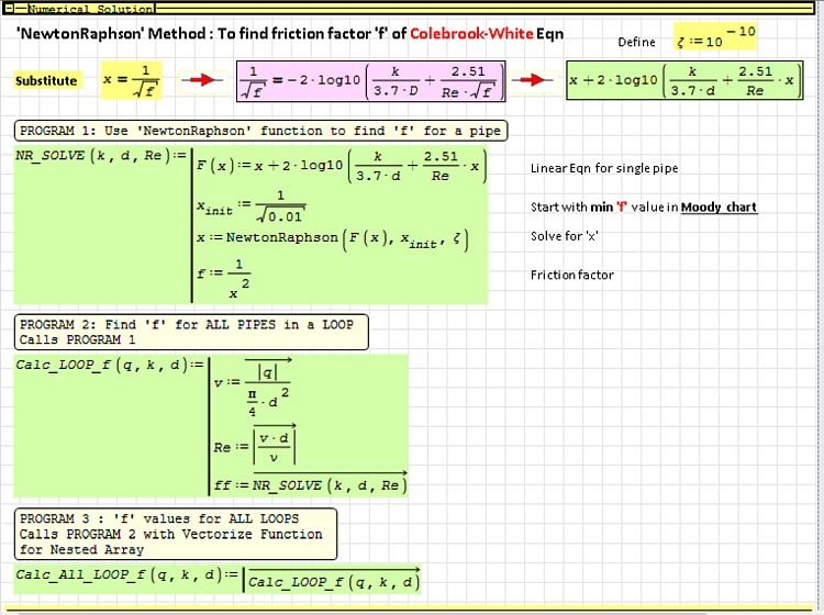

Hardy Cross method revisited.
The friction factor for turbulent flow is calculated using the Colebrook-White equation.
Due to the implicit nature of this equation, calculation of the friction factor requires an iterative solution via numerical methods. Hence, many explicit approximations have been proposed such as Haaland, Moody, Jain etc. to simplify the calculation process.
The attached sm file shows the iterative method of solving the Colebrook-White equation to calculate ONLY the friction factor ‘f’, for use in the Hardy Cross method. The calculated pipe flows were well within the values obtained in my last example.

#10 Опубликовано: 18.04.2021 12:28:52
Thanks for sharing the improved project method.
Take care ... Jean

My aim was to demonstrate basics of Hardy Cross method using SMath and and the importance of
the Vectorize function when dealing with nested matrices.
