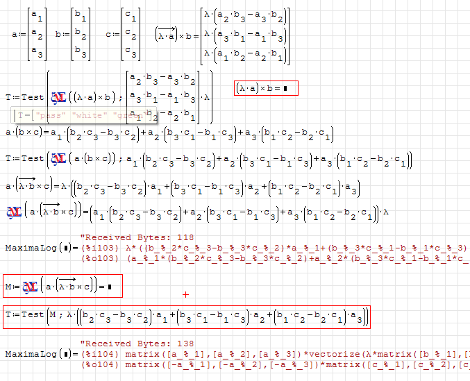

The expression a*(vectorize(λ* b )†c) displays correctly, if directly written to a math region, also if it is wrapped in Maxima(). Maxima doesn't do a lot here, all is done on the SMath side.
However, if it is used in a definition, then SMath complains about wrong arguments for the cross product.
How can I avoid this?

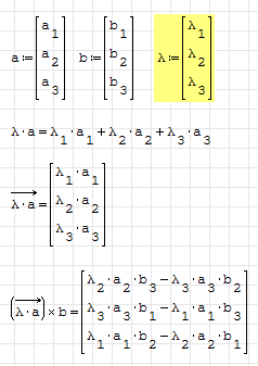

As for my point of view, the wrong thing is the result given in (vectorize(λ*a))†b; since λ is unknown (and there fore type of λ), vectorize() it should be hold in the formula until will be defined.
Just think if I'd like to use a vector as λ:
![2017-08-23 12_09_07-SMath Studio 0.98.6398 - [Documento5_].png](/ru-RU/files/Download/5mzUWy/2017-08-23-12_09_07-SMath-Studio-0.98.6398---[Documento5_].png)
