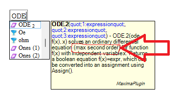

Why is saying that its not a proper differential equation?
#2 Опубликовано: 07.10.2024 17:20:54
StvMath
StvMath
44 сообщений из 76 понравились и 1 не понравились пользователям.

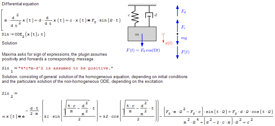

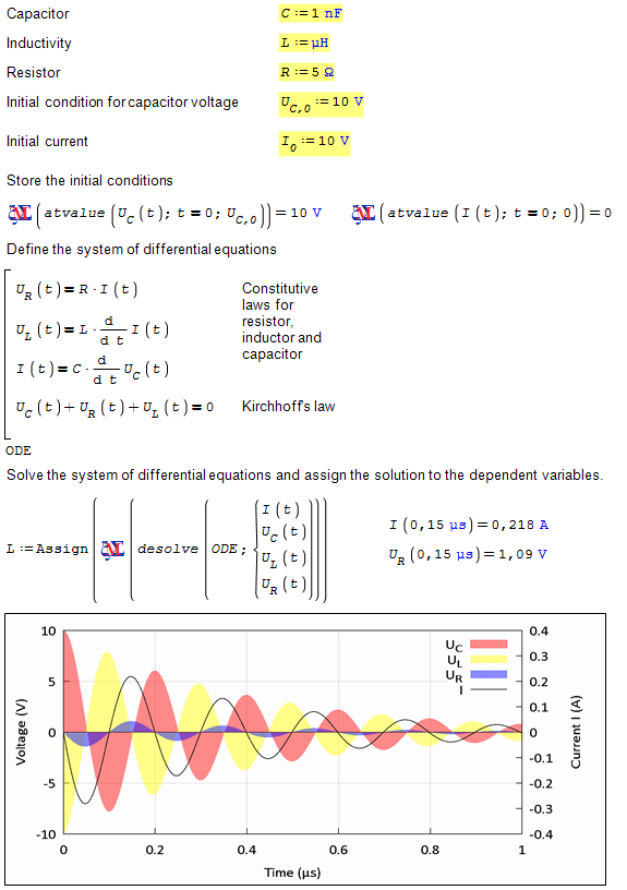

Sure. Here is one using Maxima's desolve function and one using ODE.2 (without solving for the integration constants)
RLC.sm (23,17 КиБ) скачан 1694 раз(а).
Feder-Masse.sm (23,13 КиБ) скачан 1699 раз(а).

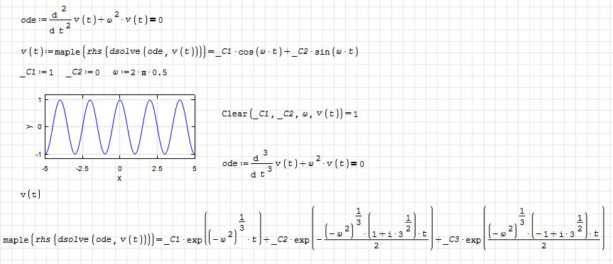

Martin, do you have an example for a third order differential equation on how to solve it? because ode2 is limited to second order differentia eq as far as I understood. And my previous question was on how to sollve a differential eq of order > 2 (3, 4, etc)?
#8 Опубликовано: 09.10.2024 18:47:10
Here I cirumvent the limitations of the translation using multiple intervals of integration. Example from the interactive handbook.
Worksheet36.sm (40,73 КиБ) скачан 2393 раз(а).
