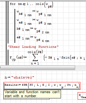

Attached is an older worksheet for simple span beams. It used to "work". However, now I receive an error "Variable and Function Names Can't Start With Number". I can't seem to find this error.
Any help would be greatly appreciated.

there are known issues with the iterator name of functions like sum, if that variable was previously defined; just clear it before using inside sum.
That what it means. Since 6179, Sum needs be locally defined.

You can, but you might experience the issue again if that variable is used somewhere and then you call your function
Clear() is the most reliable way to act, and won't change the logic of your function even when this issue will be solved

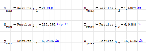

1. I seem to get a bad result (it is incorrect) as noticed by the units. I'm not sure what's going on there.
2. Where is 'n' being defined in the original function? Or do I need to clear(n) before every sum?
Thanks again!

Thanks for you help. A couple questions:
Not really sure what's going on there while the units are correct, but they shows that something is messed up. What is going different is that nested systems are no more joined (at least for the el() function).
In the for loops before the sums. Try it on the canvas, the iterator variable is available with his last value outside the loop (by design).
before any sum in which you might not have the control on what is defined before; In this case, the first sum() inside the function, whatever you use or not use n locally, because n might be used on the canvas. If you still want to use n in amid of 2 sums, you have to clear it again before the second sum. However if you forget it the error status shows that something is gone wrong.

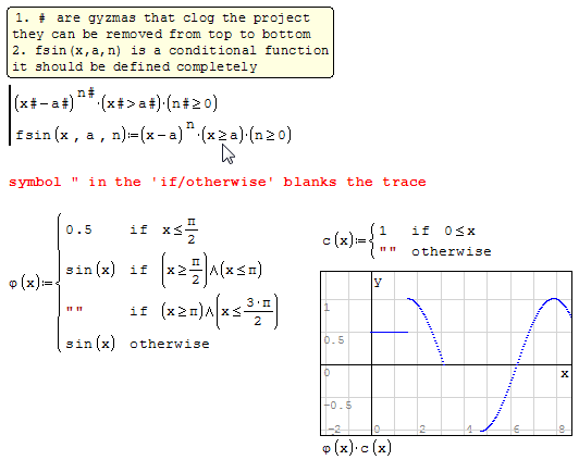

Please, check the attached:
1. Not a case of clearing anything
2. Changed the nSum for mSum
3. Removed all gyzmas #
4. NO error message
I understand nothing in that kind of work,
but results make sense even with units.
