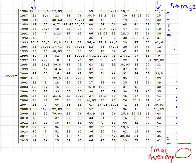

hi...I need find the average of each row (without include the first number) and at the end find the average of all averages....thanks for the help

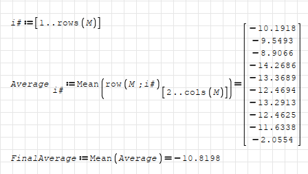

#4 Опубликовано: 18.06.2021 08:02:29
Had you attached the table ... job done.
Average.sm (9,28 КиБ) скачан 1015 раз(а).

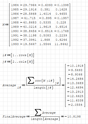

#5 Опубликовано: 18.06.2021 08:07:34
1 353 сообщений из 2 265 понравились пользователям.
Another version with scalar product.
Easy to adjust to arbitrary subsets of columns.
avg.sm (6,53 КиБ) скачан 1039 раз(а).
