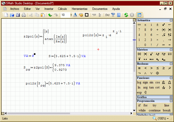

Something like that?
Notice that atan2 ins't in SMath, which is more correct than atan for this functions (see http://www.mathworks.com/help/matlab/ref/atan2.html for example).
Davide Carpi 05.06.2016 19:28:00

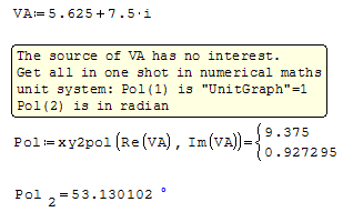

#10 Опубликовано: 05.06.2016 19:57:34
In this specific set of applications I have no interest in "numerical MathEMATICS". [Basile]
From A...Z, Smath is a numerical math tool as any other CAS and including your specific application.
xy2pol result is a vector of two components that need no unit as they are implicit. Extract each
component and append a dead unit decoration for clarity to yourself and the reader.

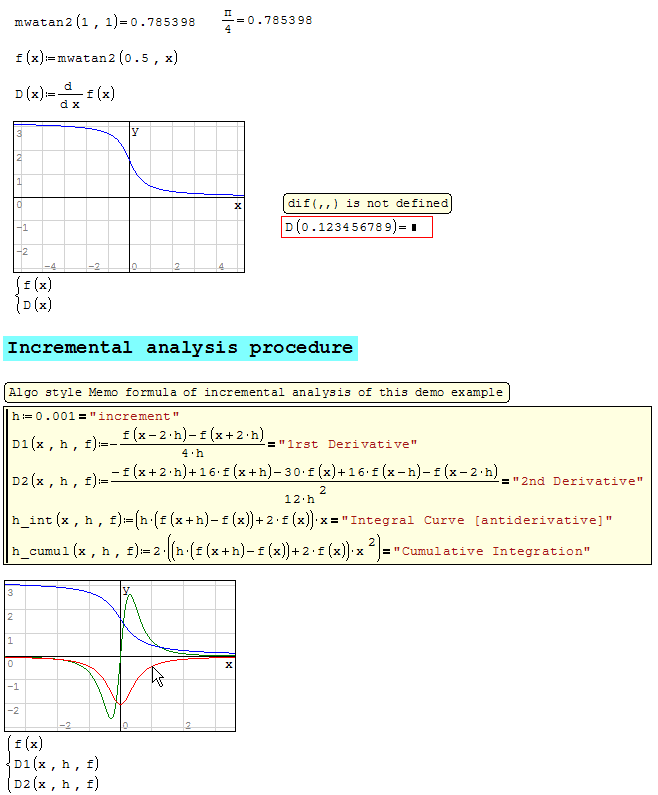

Hi Mike. I prefer this other, but have some round inconvenients:

So, this with numerical optimization must to be the best solution (until atan2 not be in SMath):

#16 Опубликовано: 06.06.2016 10:11:40
Like this Alvaro: look for the Matlb code in the f(x) menu,
look for mwatan2 ... if you have in your version: then go
Maths atan2.sm (10,93 КиБ) скачан 1094 раз(а).
