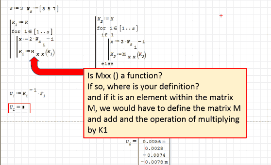

WroteI wonder why left matrix give error and right is ok?
They are identical, but the left one is incompletely dressed.
I don't understand the project. There is nothing more confusing
than subscripts. They are useful if the subscript is a long explicative definition.

WroteI think some definitions are missing
No, it's the operator formatting of the built-in minor() function. Can be found on the Matrix palette.
Ufss!!! Sorry !!!
You are right.
How I did not see it defined in the floating panel?

Seems some issue in the symbolic engine about the inversion of minor() when there are units
Because the right one comes from an if/else, that force a numerical optimization context while in the left case it's in a symbolic context.
To figure out the difference between K.1 and K.2, look at their content
- add a breakpoint on Mxx and look what it happens inside the loop in the 2 cases
- alternatively write on the canvas K.1= and K.2= with "none" optimization
![2018-03-09 09_33_13-SMath Studio - [Test1.sm_].png](/ru-RU/files/Download/qnPhmT/2018-03-09-09_33_13-SMath-Studio---[Test1.sm_].png)
WroteBecause the right one comes from an if/else, that force a numerical optimization context while in the left case it's in a symbolic contex
About all that: my understanding is only slightly pregnant !
It resumes to solving a tridiagonal system c/w units
conclusively resulting in valued units and coefficients.
Most interesting for more bed time reading.
