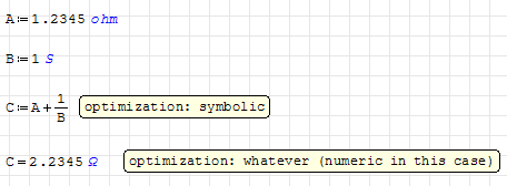

I have run into a problem with using units which are reciprocals - specifically Ohms and Siemens.
If I try to add a quantity with units Ohms to the reciprocal of a quantity with units Siemens, an error occurs: Units don't match.
Due to computer limitations where I am presently, I have only text entry.
Example:
Ra := 1 Ohm
Ga := 1 S
Rsum := Ra + 1/Ga = "units don't match"
But they do cancel:
Rprod := Ra * Ga = 1
Is there a work-around I'm missing somehow?
Thanks,
Fred

Hello Fred,
it is a bug; as workaround you can transit through a 3rd variable with symbolic optimization on his definition, then it is possible to evaluate numerically this variable in a separate region (see the cloud example)
![2016-08-06 15_21_29-SMath Studio Desktop - [OhmSiemens.sm_].png](/ru-RU/files/Download/A5YsGv/2016-08-06-15_21_29-SMath-Studio-Desktop---[OhmSiemens.sm_].png)
