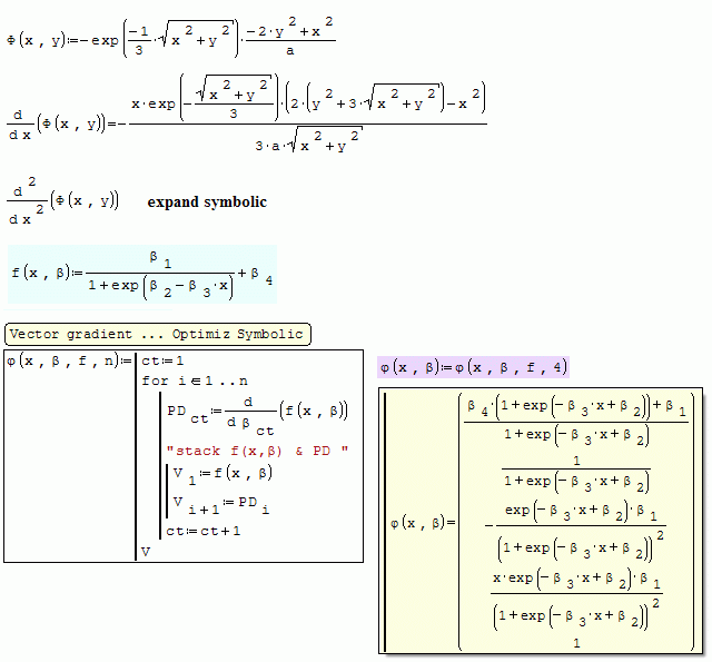

Oh, another thing. For me "variable" is that thing that can you can use second arg in diff. MapleV accept only names, but higher versions also take other things, like vector elements (V[i], for example) which is very very useful. And what I try actually is some kind of independence test. The best independence test that I know is, preciselly, diff(f,x)=0.
And sorry Uni for post this things here, but my original intention was implement try function inside of a script in vb or python, and other functions like Is testing and those others.
The way you write "diff(f,x)=0" ... I read 1rst derivative of 'f' wrt 'x'
then equate to 0 for roots. Simple: assign diff(f,x) to a new function,
for instance ff(x):=diff(f,x) ... equate ff(x)=0 for roots.
For the derivative of a vector, if the vector is not smooth you get derivative
+ an immense amount of noise. If the vector is smooth from a function, then get the drivative from the function, then evaluate at points. It could be Maple spline the
vector but that is as bad as good as you know nothing under the hood.
Cheers, Jean
