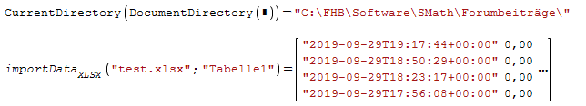

As was already mentioned, you can import to xlsx using excel with comma as column delimiter and then import to SMath Studio.
BTW, there is a glitch in mouse handling of the matrix resizer. It seems to compute the mouse drag required for resizing based on width of the first column.
importtest.sm (3,26 КиБ) скачан 1346 раз(а).
test.xlsx (11,49 КиБ) скачан 881 раз(а).

Thanks for all the suggestions.... I think the xlsx option will be manageable for now - thanks.
Shame the importData function is not a bit more forgiving.
